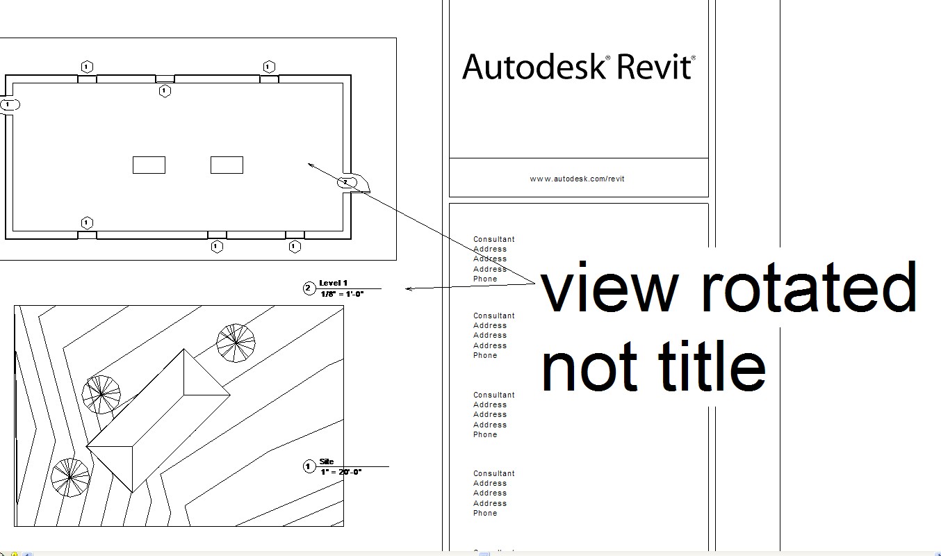

Fri, Mar 7, 2008 at 7:32:28 AM | Rotating Views On a Sheet
eldados,
He said view title...  here is view rotated but not the title.
