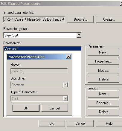

I have done this by adding a shared parameter to the views category then setting my broswer up with that as the second sort.
To do this,
- under file / shared parameters, create a new shared parameter.  I called mine View sort.  I creted mine in a group called views ( You may have to add that group.)

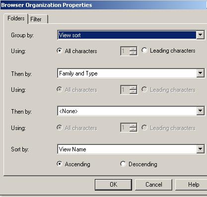

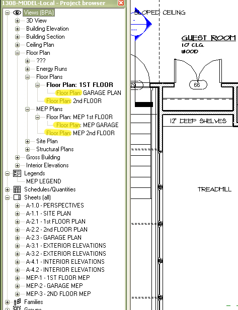

Ok works like a dream...but, is there anyway to get rid of the "Floor Plan" that sits in front of every name?  Take a look at the image.
Thanks

That never shows up in my browser. Are you useing Arch, MEP or Str? My guess is that you have something set in your browser organization that adds that prefix. Can you post a shot of your broswer organization? Might help to better answer your question.

Here you go.  This is what I have set up.  Is there somthing I'm missing?  thanks,

Apparently if you just sort by "Type" then it inserts the Family before the view name. We have alsways sorted by "Family and Type" so I had never seen this before. If you change your sorting it should get rid of the "view family name:" portion.

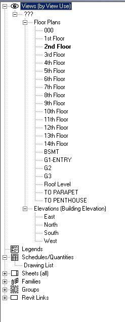

WWHub you were a lot of help, I hope you can help me with one more thing.  As of right now i have one folder called ??? and within that i have 2 sub-folders (Floor Plans, Elevations) How can i create more folders under the Views(byView Use).  In other words i'm trying to create a folder and and later add other sub-folder views.

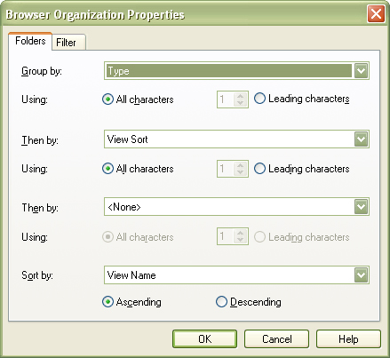

It appears that you are sorting by paramter 1 and parameter 2 but have not assigned a value for p1. The ??? is when you have not assigned a value to the parameter that you are sorting by.

You just need to find the parameter that you are sorting by in the element/ view properties and then assign it a value.
If that doesnt help send a screen shot of your browser sorting.
Nick
