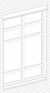

I'm trying to cut out a void in the wall so I can add a window sill and lintel back in.
I define the wall as Work Plane, model the Void Form, then Cut Geometry from the wall.  3D View reveals success within the massing editor.  But when I go to Finish Mass it says:
"This Mass has no solid geometry for its Void Forms to cut. They must be deleted, or solid geometry added and cut."
Okay...  so I try to model the Solid Form of the Lintel while I'm still in there, and select Finish Mass and get the same error.  The only option to continue deletes the voids from the wall.
Anyone know what I'm missing?

That's it!  And now the problem/logic seems obvious: a void in the wall has to be formed in the wall category.
I was using the Massing tab on the design bar.  Whoops!

I would like to point out that if you are trying to create a void to remove geometry from an existing mass, use the create tool and select generic model. If you are trying to use the mass tool, then the void needs to be created with the mass so it can read all the geometry. Simply put you can't have a mass consisting of just a void. If you use the generic model option you can cut your walls, floors, what ever.

I'm doing all of this as part of the lintel and sill detail of my windows.  Is there a way to group or nest or combine in some fashion the Voids with the Window so that it copies with every instance - and I don't have to model it for each one?
The complication is that my windows are aluminum storefront, which Revit categorizes as a wall type.  So the "window" itself (and it's custom mullion layout) is not a window family - it's grouped for copying.  Good strategy?  I'm sure there's a better way.
