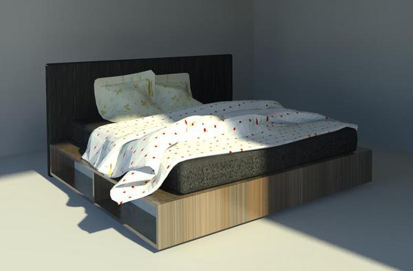

comments and rate please.

rate and enjoy sleeping.have a nice day

Have you checked the dimension on the bed. I loaded the bed into one of my projects and the bed is too small. Pleas check the size of a queen and king size bed and compare it to the bed you made. Overall the bed looks good, but the scale is off.
It would be also nice if you included night table and lamps. it makes it easier then shoep for something to macch.  thanks.

reidclifford..i check the scale...its fit the quensize bed...check on it..please go to family...then use dimension...it shows the dimension of the bed....

definately too small the bed is only 1269mm wide by 1349mm long and is only 640mm high. below are the sizes of mattresses from different countries
Mattress size (width × length)  N. America[1]Australia[2]UK/Ireland[3]Continental EuropeLatin AmericaJapan[4] Single/twin 39in × 75in97 cm × 191 cm 36in × 75in92 cm x 187 cm 36in × 75in90 cm × 190 cm 35.4in × 79in90 cm × 200 cm 38in × 77in97 cm × 195 cm Double/full 54in × 75in137 cm × 191 cm 54in × 75in137 cm x 187 cm 54in × 75in135 cm × 190 cm 55in × 79in140 cm × 200 cm 55in × 77in140 cm × 195 cm QueenKing (UK/Ire.)Wide Double (Japan) 60in × 80in152 cm × 203 cm 60in × 78in150 cm × 200 cm 63in × 79in160 cm × 200 cm 61in × 77in154 cm × 195 cm Olympic QueenQueen (Japan) 66in × 80in168 cm × 203 cm       67in × 77in170 cm × 195 cm KingSuper King (UK/Ire.) 76in × 80in193 cm × 203 cm 72in × 80in183 cm × 203 cm 72in × 78in183 cm × 198 cm 75in × 79in190 cm × 200 cm 76in × 77in194 cm × 195 cm California KingKing Long (Japan) 72in × 84in183 cm × 213 cm       76in × 81in194 cm × 205 cm

Not to size. (too small)

I like design, but the bed is non-propocial.

Way too small. What is this? A bed for ants?
