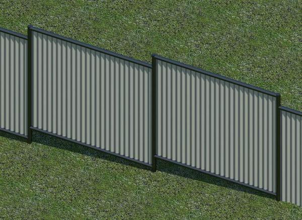

Here we go, a great parametric colorbond fence which adapts to the site slopes. Just follow the instructions to use it:
First of all, it only works as linear arrays, never curves.
1) Insert the component making sure its host is the site surface.
2) Measure the total distance of the line you want the fence on and subtract 60mm, which is the post diameter.
3) Divide the total by the panel length, for example 2100mm.
Example: if we have 22578mm to fence, subtract 60mm and divide by 2100mm. That gives me 10.72
4) Round this number to the next integer. In this case 10.72 becomes 11.
5) Divide the total (22518mm) by 11.
6) Open the Fence Properties and change its length to the result (2047.09).
7) Create an array of 11 parts with the panel.
8) That's it. Done!
