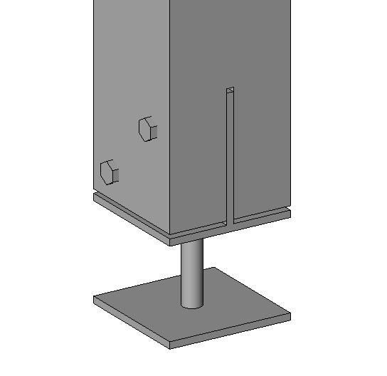

Metric Structural Column Family (Timber Post with Centre Fix Post Anchor). This Model is parametric allowing:Different Timber Post SizesAdjustment of Stirrup Foot HeightMaterial Assignment for Timber post and Stirrup assembly This is the first out of the ordinary Family that I have had to create and I thought I would make it my first contribution to RevitCity. I hope someone else out there can find useful.

Very nice, but it does not offset with the associated level. I am trying to offset -150mm from Ground Level but the "offset" parameter is not functioning. Is it possible to fix this, and if so, how?

Here is how toe fix the Family.
Open the family
go to the front view
Move the Lwoer Ref Level Up.
You will notice its not attached to the bottom reference plane
Align and lock the reference plane to the Lower Ref Level.
Save and import back into your model.
