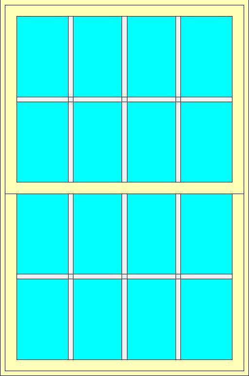

Andersen single wide double hung
9324 Downloads
5 Stars from 4 Votes
This is a full catalog of Andersen Tilt Wash single wide double hung windows. Unit ID is Andersen nomenclature, i.e. 3046. Rough openings are per catalog and should be accurate per mfg specs.
2 files to download: Family and Catalog
Note: units with 56 are equal height sash. Andersen standard units for this height are cottage units and available as same height sash.

rpiboy2
Joined Fri, Mar 11, 2005
Are you defining the sizes based on unit width or rough opening. With Anderson casements the average extra space for a rough opening is 1/2" but not always. Therefore on my units I always defined everything based on RO so that it would be dimensionally correct, then subtracted 1/2" to determine unit size. If you are being so exact as specifiying Anderson Units, then model number and RO are going to be more important then exact unit size or dimensions.
