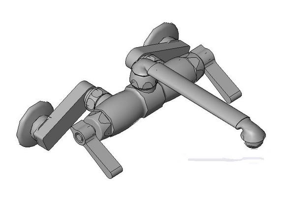

This is a CHICAGO FAUCETS a Geberit company product, i have the autocad drawing of the front view and side view wihich i was challenge by its form how to do it on revit and i was glad i made 95% of its figure i think..got to see it for yourself..RATE IT PLS?THIS IS MY FIRST UPLOAD!THANKS

Very Good...

nice design... easy to alter if necessary. good job!

Thanks! -.-"

Nice Sweep Blends & Revolves. For Product Information Model (PIM) consider the following  for ptimization:* Simplify Solids by removing Voids* Turn off 2d Visibility for all Solids* Add abstract Symbolic Lines for all 2D views* Purge unused* Nest Half of the Solids & Mirror in New RFA (takes up less space when copied in RVTs)Keep in mind that the operative word in BIM is Information and that Visual Data can easily overload an RVT. ☺ http://usa.autodesk.com/adsk/servlet/ps/item?siteID=123112&id=13126290&linkID=9243099
