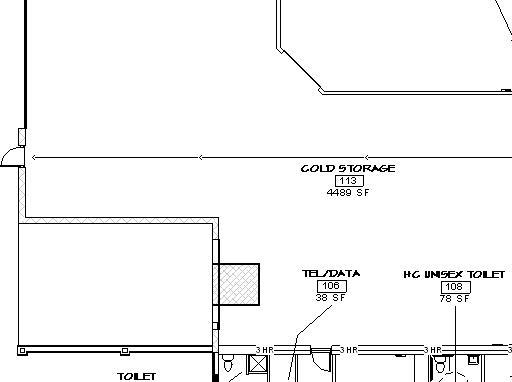

Detail component line with replaceable symbol and control of number of symbols. Useful for fence, utilities, egress route, etc.

if you replace the fixed number in the family-types properties, by a formula like:
=(Length/1000)+1
Then you have a true easy-scaling line... (you can choose yourself by which number to divide a.k.a. how often repeats you want per unit)
