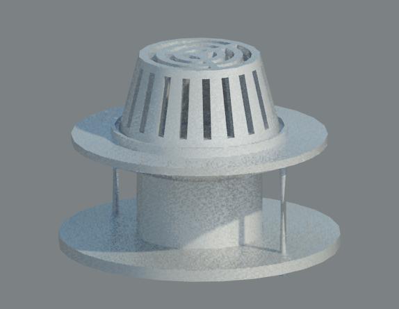

auto sizing roof drain
14342 Downloads
5 Stars from 5 Votes
assign it a rainfall rate, and total surface area (has ability to include vertical surfaces as well)
It will size the pipe dia based on michigan plumbing code
-can be adapted for other states, based on Wade
Based on 1% slope I intend to include rates based on 2% slope at a later date
Product Version: Revit MEP 2009
Uploaded By: KKERRIDGE
Uploaded On: Fri, Oct 10, 2008
Original Creator: Kristin Kerridge
Wed, Jul 22, 2009 at 8:14:43 AM
rwdywill
Joined Tue, Jul 21, 2009
I can view this in 3D but not in plan. Is there something that needs to be turned on or off?
Fri, Jan 6, 2017 at 8:22:23 AM
renderforfun
Joined Fri, Sep 24, 2010
4.5 Stars from 6 Votes
I know this is super late but if you go to the visibility graphics of the view you are trying to view it in and make sure Plumbing Fixtures is checked to be visible.
If its your roof plan most likely you have that turned off right now.  I had to do the same things.  Hope it works.
