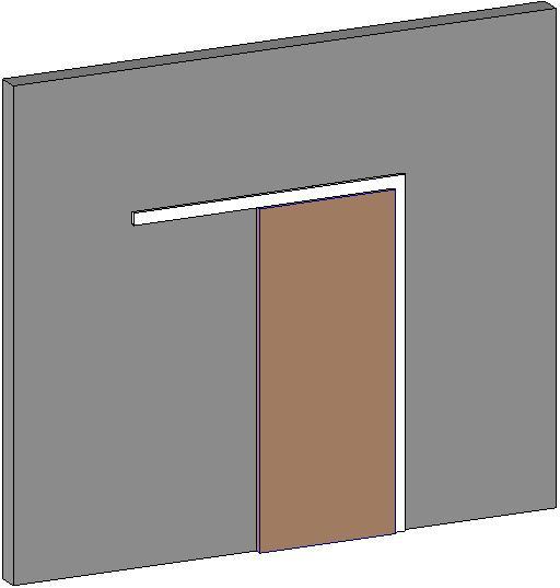

One-Pane Sliding Door
Simple One-Pane Sliding Door
Uploaded By: rmaciel

I need help with changing the size of the door. When I tried, it gave me error. Could it be because I am working with inches and feet?
Mon, Dec 8, 2014 at 3:32:45 AM
dobrinZ
Joined Sun, Apr 21, 2013
The trim width of the trim on the interior side is not correctly set. You have to edit the interior trim which is an extrusion and to set the width of the right side.
