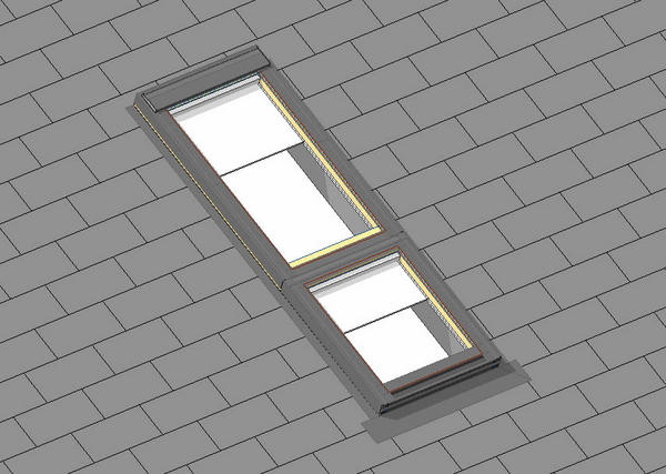

Roof window VELUX M08 M34 combination
780 x 1400mm top-hung roof window over 780 x 920mm fixed roof window with flashing and blind set in generic 300mm roof.

thanks for the great selection of rooflights, but they dont seem to render and i cannot asign a material to it, can you advise,
Thanks
Will
Thu, Jul 28, 2011 at 7:48:09 AM
vovovo
Joined Wed, Apr 23, 2008
I have the same problem. Is it possible to do it?
Tue, Mar 5, 2013 at 10:21:25 AM
Dutzy
Joined Fri, Sep 16, 2011
If anyone else has the same problem;, Click the View-tab - Visibility Graphics - Object Styles - Imported objects, and here you can find and change the materials of the Velux family.
