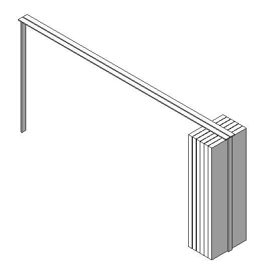

Folding Partition - Paired Panels
Parameters for room width, ceiling height, panel thickness, max panel width.  Based on Modernfold 942.

- Ceiling Height parameter does not work.
Fri, Sep 26, 2014 at 10:37:14 AM
mgroch1
Joined Thu, Mar 3, 2011
If you edit each panel group and change the work plane to Reference Level this solves the ceiling height problem. Good family otherwise.
