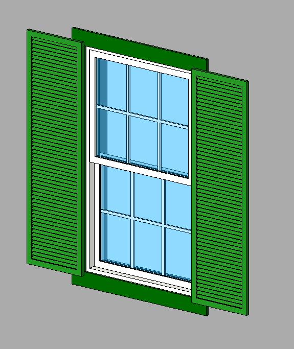

Double hung window with shutters
10040 Downloads
5 Stars from 5 Votes
CSI Division: 08 Openings
RevitCity Division: Windows
Product Version: Revit Building 9.1
Uploaded By: JAMESHGRIMES
Uploaded On: Thu, Dec 28, 2006
Thu, Dec 28, 2006 at 8:48:40 AM
JAMESHGRIMES
site moderator
JAMESHGRIMES Avatar
Joined Fri, Apr 14, 2006
4.5 Stars from 10 Votes
Parametric for width and height. Also has instance parametrers for shutters, trim, and grid

Thu, Feb 28, 2013 at 7:32:03 AM
Snyderjp15
Joined Wed, Jan 16, 2013
cannot change color of the shades themselves ... is it possible to do this?
Thu, Feb 28, 2013 at 7:32:37 AM
Snyderjp15
Sat, Mar 26, 2016 at 12:56:00 PM
dannost
Joined Tue, Oct 21, 2014
Also tried to change color of the shutters and cannot.  Any ideas?
Mon, Aug 22, 2016 at 9:32:08 PM
KyleB
KyleB Avatar
Joined Sun, Dec 3, 2006
You need to map the geomerty in the nested Shutter Families to Parameters in the Window Family itself.  I uploaded a modified version -> http://www.revitcity.com/downloads.php?action=view&object_id=17661
