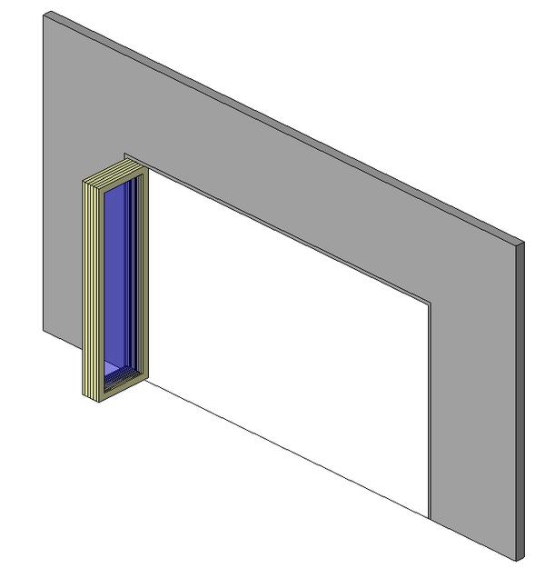

hey if anyone has used this family is it possible to close and open the stacks in elevation or floor plan. id like to be able to close them for elevation but have them open in 3d..thanks if someone can help
Thu, Jan 11, 2007 at 8:39:52 PM
DaveM
Joined Mon, Oct 2, 2006
If you change the view property for that view to Medium -Doors Closed–                                                                       Fine-  Doors OpenYou can also change the number of door panels, which will change the number of side panels As well the side panels change length / number to suite opening size. and number of doors in opening
Thu, Jan 11, 2007 at 8:43:24 PM
DaveM
Sorry this is a bit betterIf you change the view property for that view to
-Medium -Doors Closed
-Fine-  Doors OpenYou can also change the number of door panels,which will change the number of side panels As well the side panels change length / number to suite opening size. and number of doors in opening
