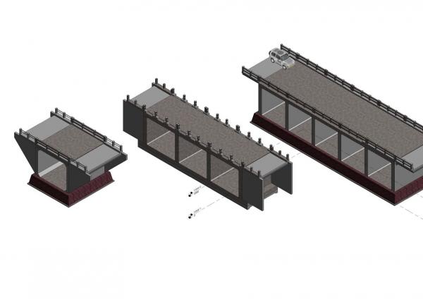

It is a RCC Box Bridge for one to multy spans. Number of spans, Clear span, Clear height , Road width params can be set independentely. Approach slab, Return walls, Cutoff walls, Drop key etc. can be placed/remove at will. In autoset dimension for foundation Raft, end & inner webs as well as deck slab is set as per span, while in MORTH setting one can set these dimensions manually.  For longer length of bridge  repet & align family providing expansion joints. In this case Return walls & approach slabs be off. Provision to off/on for Cut off wall, Raft Key, left & right Return wall & Approach Slab have been provided. Railing of main bridge / on approach can be set indepentely. Number of span is ristricted as total length of bridge may not exceed 30 mtrs. for more length add more bridge. The box type bridge is revised up to date, as this was loaded in 2006 on this site. Lallan Ji Upadhyay. Varanasi.
