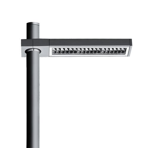

AVENUE STREET LIGHTING 36led
Art. S.3090N36 MODULES LED 4000K  220-240Vac 12614lm CRI 80 MacAdam step 3Rated luminaire luminous flux: 9976lmRated input power: 107WLuminaire efficacy: 93lm/WElectronic ballast  ON/OFF not dimmable CE - ENEC 03LUMINAIRE TYPEPost top luminaire. IP rating IP 66MATERIAL CHARACTERISTICSExtruded EN AW-6060 aluminium profile, die-cast EN AB-44100 aluminium housing (copper free) with high corrosion resistance. Stone wash surface treatment prior to painting process. A4 grade Stainless Steel screws with 2,5-3% molybdenum content which increases the resistance against corrosion. Pre treated Silicone Gaskets. Painting Process : 3 Step Process1) Surface treatment with BONDERITE. A heavy metal free chemical surface treatment containing ceramic nano particles giving a cohesive, inorganic and highly dense protective coating. 2) PRE POLYMERIZATION a process of introducing an epoxy primer with excellent characteristics to the paint which also offers very high resistance to oxidation due to its Zinc content. 3) POLYMERIZATION a process with the application of polyester powder with high resistance against UV rays and harsh weather conditions. Resistance test protection for Marine applications for 1200h. Mechanical resistance IK 07LIGHTING PERFORMANCEThe circuit is characterized by a series of LEDs specifically oriented to assure excellent light distribution on the street. PARK supplied with electronic circuit with temperature sensors for each LED to optimize the lifetime. The light distribution is in accordance with light pollution regulations. Lamp  fixed position . LOR -- POLE CONNECTIONPole mounted in painted aluminium with Ø 102 mm connection. ON REQUEST ADAPTOR for cylindrical poles Ø 76 mm.WIRINGPROTECTIONS AGAINST DISCHARGES AND HIGH VOLTAGE SPIKES, Controlgear equipped with protections against discharges and high voltage spikes on the mains: 3,5kV differential mode (L-N), 4,0kV common mode (PE).Luminaire hard wired with H05RN-F cable. Fast connector IP67 (Ø 6÷12 mm) supplied as standard for single cable connection . Isolation: CLASS II . Available colours: Anthracite grey (cod.24). Weight: 18.96 Kg Glow Wire test: -- Exposed windage area : 0,06 m² ( 1000mm ), 0,05 m² ( 800mm ), 0,04 m² ( 645mm )LED circuit included.AVENUE PATENT PENDINGThis luminaire contains built-in LED modules. In case of damage or malfunction please contact the manufacturer to receive additional instructions on how to replace and relative spare parts to order. The LED modules cannot be handled in the luminaire by the end user.LED modules are engineered accordingly to the existing regulations of Lumen Maintenance (LM80) and Technical Memorandum (TM21), where uniformity and quality of the light is 70,000 hours referred to L80 B10 Ta 25 ° C (50,000 hours referable to L80 B10 Ta 40°C). Lifespan of the luminaire > 50,000 hours at 40°C. Performance Ambient temperature Tq 25°C. Operating ambient temperature range is from -20°C to +50°C. Storage temperature range from -20°C to +60°C.
