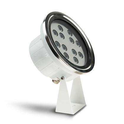

POOL SPOT
Art. S.3693 12 MODULES LED RGBW (W=6000K)  24VdcRated luminaire luminous flux: 430lmRated input power: 31WLuminaire efficacy: 14lm/WRequires remote ON-OFF power supply or Dimmable power supply CELUMINAIRE TYPESubmersion luminaire. IP rating IP 68MATERIAL CHARACTERISTICSTalc-filled technopolymer housing. Marine grade stainless steel AISI 316L front trim 2 mm thick. A4 grade Stainless Steel screws with 2,5-3% molybdenum content whitch increases the resistance against corrosion. Toughened transparent glass 4mm thick for MICROPOOL SPOT, 8mm MINIPOOL SPOT and POOL SPOT. Mechanical resistance IK 10 Silicone gaskets.LIGHTING PERFORMANCEThe spectral distribution of the light is intended to change the appearance of the scene or object lit. Not intended for use in other applications. Lamp  fixed position. LOR -- WIRINGPOOL SPOT requires a FLANGE accessory to anchor the fitting to the bottom of pools or fountains. The stainless steel flange is supplied with fastening screws, both for fixing the fitting to the flange and for the anchorage to the bottom of the pool. Should the fixation with screws be impossible, the weight of the accessory still allows to keep the luminaire sitting on the bottom of the pool. Single cable entry with M20 brass cable gland. Luminaire hard wired with 6 m. cable (5 x 1mm²) cable type H07RN8-F for MICROPOOL RGBW, 6 m. cable (5 x 1mm²) cable type H07RN8-F for MINIPOOL RGBW and 8 m. cable (5 x 1mm²) cable type H07RN8-F for POOL RGBW closed by cable gland and sealed with B component epoxy resin, wired internally protected by silicon sheaths Isolation: CLASS III . Available colours: Stainless steel (cod.19). Weight: 4.48 Kg LED circuit included. Not suitable to install outside the water.The luminaire cannot be installed out of the water. Not compatible with pools containing salt water and that are treated with salt water chlorinationPOOL REGISTERED DESIGNThis luminaire contains built-in LED modules. In case of damage or malfunction please contact the manufacturer to receive additional instructions on how to replace and relative spare parts to order. The LED modules cannot be handled in the luminaire by the end user.LED modules are engineered accordingly to the existing regulations of Lumen Maintenance (LM80) and Technical Memorandum (TM21), where uniformity and quality of the light is 70,000 hours referred to L80 B10 Ta 25 ° C (50,000 hours referable to L80 B10 Ta 40°C). Lifespan of the luminaire > 50,000 hours at 40°C. Performance Ambient temperature Tq 25°C. Operating ambient temperature range is from -20°C to +50°C. Storage temperature range from -20°C to +60°C.
