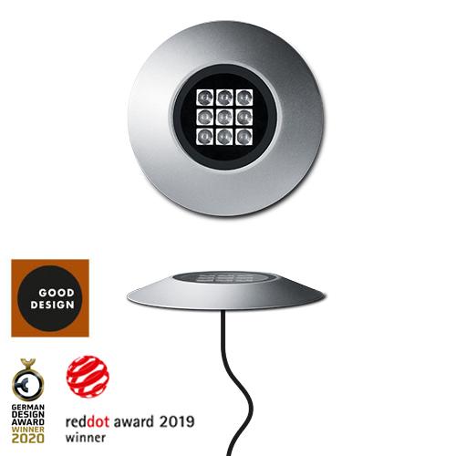

Art. S.1910W 9 MODULES LED 3000K  Max. 700mA 1755lm CRI 90 MacAdam step 3Rated luminaire luminous flux: 1569lmRated input power: 20.2WLuminaire efficacy: 78lm/WRequires remote ON-OFF power supply or Dimmable power supply CE - ENEC 03LUMINAIRE TYPESurface mounted up-light fitting . IP rating IP 65 IP67MATERIAL CHARACTERISTICSDie cast EN AB-47100 aluminium (low copper content) housing with high corrosion resistance. Stone wash surface treatment prior to painting process. A4 grade Stainless Steel screws with 2,5-3% molybdenum content which increases the resistance against corrosion. Mechanical resistance IK 08 Maximum load capacity --LIGHTING PERFORMANCEClear polycarbonate lenses. Toughened glass 5mm Micro Over-all, 6mm Mini Over-all, 8mm Over-all. Lamp  fixed position. LOR -- LOW SURFACE TEMPERATURESurface temperature of glass -- (Ta 25°C)INSTALLATION AND MAINTENANCEA4 stainless steel fixing clips. Over-all is supplied with a nylon insulating fixing base and 2 special keys (necessary to remove the luminaire). Allowing direct fixation to the solid ground.WIRINGSupply 5m cable section type H07RNF sealed with B component epoxy resin, wired internally protected by silicon sheaths. Isolation: CLASS III . Available colours: Aluminium grey (cod.14). Weight: 2.13 Kg Glow Wire test: --LED circuit included.OVER-ALL REGISTERED DESIGNThis luminaire contains built-in LED modules. In case of damage or malfunction please contact the manufacturer to receive additional instructions on how to replace and relative spare parts to order. The LED modules cannot be handled in the luminaire by the end user.LED modules are engineered accordingly to the existing regulations of Lumen Maintenance (LM80) and Technical Memorandum (TM21), where uniformity and quality of the light is 70,000 hours referred to L80 B10 Ta 25 ° C (50,000 hours referable to L80 B10 Ta 40°C). Lifespan of the luminaire > 50,000 hours at 40°C. Performance Ambient temperature Tq 25°C. Operating ambient temperature range is from -20°C to +50°C. Storage temperature range from -20°C to +60°C.
