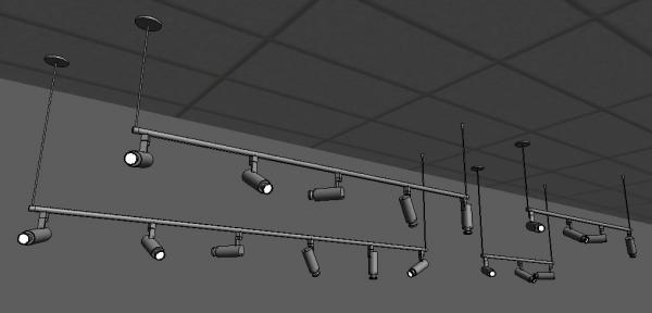

PureEdge Pipeline 10' Track w/Uplight and Adjustable Cans
1092 Downloads
Please rate and comment, thanks!
Took a while to figure out how to get these to work properly.
The track is PureEdge Pipeline with LED uplight (very cool!).  Available in 2', 4', 6', 8', and 10' lengths.  I'll be uploading the 4'-10' pieces.  The hanging height is parametric, but the number of cans and can spacing will have to be changed in family editor.
The cans are focus adjustable, dimmable, gallery series artwork LED cans found at cocoweb.com
Cans be individually rotated in project.
!!!DO NOT ROTATE THE CANS BEYOND 179 OR -179 DEGREES OR THEY WILL EFF OFF INTO LOW EARTH ORBIT!!!
Can pitch can be individually adjusted but should be kept between 15 and 105 degrees (for some reason the ACTUAL angle is off by 15 degrees, so entering 15 will set the can to zero, or parallel with the track).
The can light sources are point+spot.  The beam angle and sourounding field angle can be adjusted as well.
You can add cans, but will have to add the corresponding parameters and labels to make the new cans function properly. You'll also have to save the new can as a seperate family, ie. "Can 7", "Can 8", etc.  This was the only was i could figure to get the individual pitch parameters to work.
I'm sorry if there's a better/easier way to do all this, but I'm self taught and there's still a lot I don't know.
Hope these are helpfull for you!
