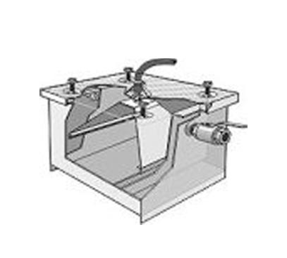

MIFAB Series MI-G-L-SDH ____ sanitary acid resistant, powder epoxy coated inside and outside fabricated 10 gauge steel hydro mechanical grease interceptor with flow rating of ____ (indicate) and grease holding capacity of ____ (indicate). Unit shall include: removable baffle assembly and cross bar, internal deep seal trap covered by lid, sewer gas stopper, securing bolt(s), external vented flow control fitting, internal air relief by pass, feet underneath interceptor to elevate it ½” off the ground, internal steel cone, flexible drawoff
hose and cap, hose clamp, line shut off valve and steel acid resistant, powder epoxy coated, non skid, rectangular gasketed lid(s).
