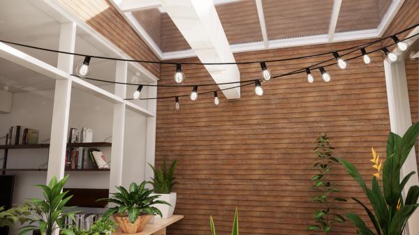

Parametric String Lights using adaptive components. Adjusting the U_VAL and V_VAL changes the placement of the inner spline point. Additional parameters include: light bulb count, ends offset, and fixture materials.
Placement seems to work best using vertical planes. If the fixture ends up facing the wrong direction - try setting the workplane to a vertical placement plane and rotating.

Not bad.  they look awesome.  is there anyway to make it more adaptable to the direction at which they hang.  I have mokeyed with it as much as I can to fudge it to at least have them hanging downwards with gravity, but they were not very nice, even when i chose to work from a vertical plane.  1 reccomendation if you can is to be able to adjust the intensity of the bulbs themselves.  besides that, excellent work, and thank you.

Place strings where you want. Then open family and tjek always vertical box. Then load in to projekt again and voila :-)

It does what it does, looks great in renderings. my only complaint is you cant use it in a project because you cant convert it to a lighting family because of the repeater.

placing in plan and then editing each end by unchecking "driven by host" in dimension instance parameter - breaks here and there but does what it needs to. thanks!
