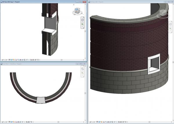

Revit 2018 Curved Wall Opening_parametric
How to use:
1. Create a curved/radial/radius wall in plan view.
2. Load the family while still in plan view.
3. Select "Place on Work Plane".
4. Place the family on the midpoint of the exterior curved wall.
5. Open a 3D view and select the opening.
6. Select "Edit Type" in the "Properties Palette" in order to enter the radius of your wall and the appropriate wall depth/thickness in the family.
7. Select "Cut Tool", select the opening, and then select the wall.
**Note: You will have to adjust the radius of the wall or the width of the opening should the family fail to flex. I created a few Family Types to help. All other Parameters flex without issue. Be sure that you enter a value for the wall depth that will cut through your entire wall.
