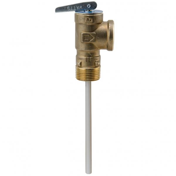

Series LF100XL Temperature and Pressure Relief Valves are used in water heater and hot water storage tank applications to provide automatic temperature and pressure protection to hot water supply tanks and hot water heaters up to 105,000 BTU/hr. They feature a Lead Free* copper alloy body with NPT male inlet and NPT female outlet connections, unique thermostat with special thermo-bonded coating, and a test lever. Model LF100XL-8 is also available with 8 in. (200mm) extension thermostat. Series LF100XL is ASME rated and CSA listed. Temperature Relief: 210 degreeF (99 degreeC). Pressure Relief Range: 75 to 150psi (5.2 to 10.3 bar). Standard Pressure Settings: 75, 100, 125, or 150psi (5.27, 7.03, 8.79, or 10.55 bar).
