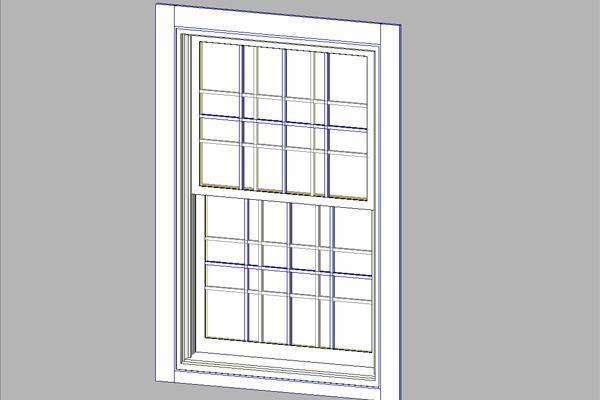

Pella DH Architect Series
Full series of sizes in one family. Variable materials and sizes, ability to change muntin patterns, trim materials and sizes, turn trim and head on and off (allowing multiple units). Also includes unit size parameter and u-value parameters and a small triangle that shows up in plan only for those sizes that meet egress requirements.

Good window with these provisions. Installation flange is set for 3/4" back from face of exterior wall and I am unable to adjust that. This makes the unit unworkable in a brick wall. A better setting would have been to tie it to the exterior of the sheathing. The trim details do not conform with real practice. The grilles and the on off features work great.
