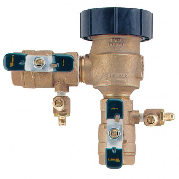

Lead Free* Freeze Resistant Pressure Vacuum Breakers - LF800M4FR Series
Series LF800M4FR Lead Free* Freeze Resistant Pressure Vacuum Breakers prevent the reverse flow of polluted water from entering into the potable water supply due to backsiphonage. It consists of Lead Free* Cast Copper Silicon Alloy body construction, silicone rubber check valve disc, plastic check valve seat, stainless steel springs, a bonnet with silicone rubber O-ring seal, a lightweight plastic disc float, a built-in relief valve to protect the internal components and the body from freezing, tee handle or lever handle shutoffs, and test cocks for winterization draining. Series LF800M4FR is ideal in continuous pressure health hazard applications where exposure to sudden freezing conditions such as on irrigation systems and industrial process water systems can occur. Maximum Pressure: 150psi (10.3 bar), Minimum Pressure: 15psi (55kPa).
