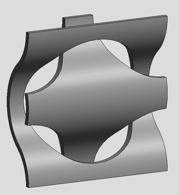

Curtain Wall Panel inspire in Erwin Hauer screen walls (continua series design 3).
I used model technique similar to this (1 simple generic model nested 8 times in a curtain panel family):
http://web.archive.org/web/20101130192206/http://www.core.form-ula.com/2007/10/14/hauer-study-design-3/
This time i didnt break flexibility, so you can use what ever square panel size you want, BUT you need to manually set the half_size parameter on panel family (if your panel size is 30 cm you need to modify panel parameter half_size = 15).
parameters:
1. half_size: curtain panel size / 2, i think it could be automatic if you use a shared/reporting parameter.
2. offset: distance between the two interlocking panels.
3.  P_ofactor: offset factor from center's geometry.
4. P_rfactor: radius factor for void geometry.
5. P_tfactor: thickness factor.
As you notice, i use multiplication factors related to size panel.
how to use it: open family, choose load to project and create a new curtain wall with CW panel EH family (also remember setting a square size cw panel and put that info in "half_size" parameter on panel type parameters).
as always, you can change type parameters to instance parameters and go crazy...
