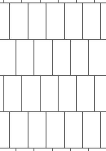

12" x 24" Tile Pattern (1/3 Stagger Horizontal)
9193 Downloads
5 Stars from 3 Votes
This is a .pat file for a 12" x 24" tile pattern that is staggered by 1/3 each row horizontally.
To use this, download the file and save it to your file directory. Then, in Revit, create a new model hatch. Edit the hatch to be "Custom" instead of simple, and then import the file.

FYI, your PAT describes this as a 12x12 Tile pattern, but it is clearly 12x24, as your description on Revit City states. Otherwise, nice pattern!
From the PAT:
*12X12 TILE ASHLAR THIRDS.    (Incorrect - should be 12x24)
;%TYPE=MODEL
90, 8, 0, 0, 12, 24, -48
0, 0, 0, 0, 24, 24, 0
90, 16, 24, 0, 12, 24, -48
90, 24, 48, 0, 12, 24, -48
