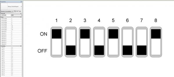

Here's a switchboard for addressing up to 256 devices? I just made it for the challenge--eletrical/data is not my field.
This annotation automatically converts any integer up to 256 into its (up to) 8 digit binary eqivalant, and moves the toggles to the correct locations.
There's some parameter kung-fu in there.

This is very interesting use of parameters. I would not thought to do this. Awesome work. Would be good to add a parameter that handles is someone enters a number hgher than 256 and maybe gives a text spash over the switches saying enter a value 256 or below.
