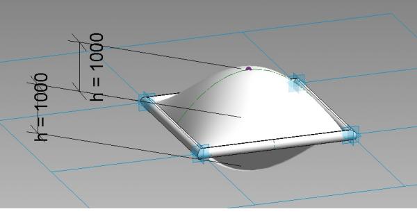

ETFE Panel
Fully parametric ETFE panel modelled as a Curtain wall panel by pattern family. This panel works with 4 sided structures and has a parameter for controlling the 'bulge' of the pillow shape and material. Also, the pillow shape is hidden at coarse and medium detail level, so be sure to turn on FINE detail level to see it!

please< can i know how to make this panel with this curve in revit?
Thu, Oct 5, 2017 at 5:06:14 PM
polmod
Joined Mon, Jan 9, 2012
just saw yuor comment now, sorry. if you download it and you open the falily and select xray youll see how it was created. i did it years ago so i forgot how i modeled it.. it was 2 straight lines and an arch in the middle with a height parameter associated with it...
