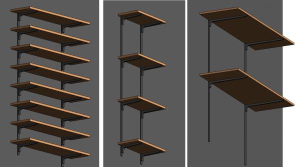

Fully parametric wall mounted shelves.
No more of this downloading each width separately nonsense. :) You can change the width, depth, height of top shelf, height of bottom shelf, width between supports, number of shelves, materials, everything.
REVIT 2016 (not 2015) The picture is all of the same family, with different parameters.

notes:
Elevation measures to bottom of wall mounted supports. Minimum number of shelves =2.
Number of shelves, spacing, and height are instance parameters.
width, depth, and thickness of shelves, and the width between the support bars are type parameters.
