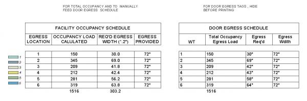

This is the finished Facility Occupancy Load Schedule and Egress Plan. This is automated to calculate the occupant load based on the type of area then use that to calculate occupant load.
There are 2 tags. 1 for rooms, 1 for egress doors.
There are 4 schedules
1.      DOOR EGRESS SCHEDULE
2.      FACILITY OCCUPANCY SCHEDULE
3.      ROOM OCCUPANCY COMPARE SCHEDULE
4.      SPACE OCCUPANCY CLASSIFICATION
There is one sample Model.
Steps:
1.      Copy the schedules and tags to your current project.
2.      Open the Room occupancy compare schedule
3.      Select what type of area you see fit.
4.      Type in 0 sf for “NON CALCULATED ROOM AREA” to calculate occupants
5.      Manually type in tag value to match calculation to populate the room tag.
6.      Place the facility schedule on the code plan sheet.
7.      Place the Door egress schedule on the sheet too.
8.      Place all your room tags
9.      Place your egress door tags on 1 exit way door only per egress area
10.   Make a note of how you want to number your egress areas. ( I usually go clockwise from upper left to lower right)
11.   Fill in the Egress area for each room in the properties field. ( You can multiple select rooms at the same time and type in the value for all at once, use your filter)
12.   The Facility Schedule will populate.
13.   Type in the Occupant value to the Door egress schedule. Make sure they match. Hide Door egress schedule.
