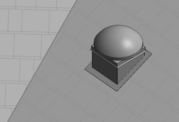

This is an instance based parametric model of a rooftop ventilation hood with an associated roof curb. The model is roof hosted and remains vertical while the base of the curb follows the slope of the roof. There are 4 main parameters that you can adjust and are as follows:
1) Roof Pitch Numerator: You will need to type in and match the roof pitch of the roof you are placing the vent hood upon. For example, if the roof is a 6:12 pitch, enter 6".
2) Roof Opening Width and Roof Opening Depth: Specify the opening you need. The Depth is the dimension along the slope of the roof.
3) Roof Curb Minimum Height: This will be the minimum height you require at the shortest height of the curb on the slope.

"There are 4 main parameters that you can adjust and are as follows:" ---- and the 4th is???

The 4th is the width.  The description simply states that the depth is the dimension along the roof slope so the width is obviously measuring the other way, side-to-side.
