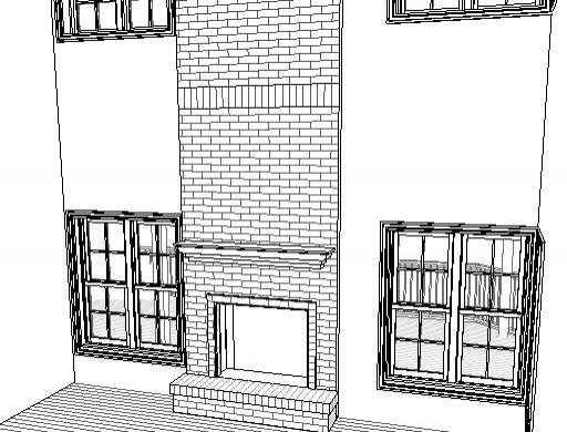

A Pretty Simple Wall Based Family to place a Mantel (No Fireplace Surround) on a wall above a fireplace.  Family has basic parameters for materials, width and depth of mantle piece.  The design is just a quick simple Sketched Profile based on an existing job I was trying to match, but you can obviously change it to whatever profile you like...If you change the profile be sure to check and realign/lock the extruded top piece to the back of the profile to maintain a solid top.  Hope that helps someone...there was really nothing here before. Also, sorry this is in 2014...I don't have an older version available on this computer.

Just as an additional comment, this wall hosts to the center of the wall on which it is place...this allowed me to get the return I was looking for on this specific mantle design, so the depth of the mantle parameter is based on the centerline of the hosting wall...just FYI.
