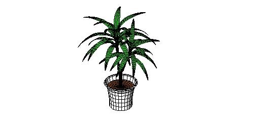

Finding a serious lack of plants on this site, I uploaded some plants I imported from autocad

My download was colourless!!

my download was colourless too.how do i make it coloured?

there is no material assigned to this block .. so need to reassign materials by layers then import it again ..

This is a dwg import with no possibilities to adjust materials... useless.

SOLUTION!
Export as a DWG
Open in CAD
Explode object
Assign each entity a layer (name them something obvious.. leaves.. dirt.. pot.. etc)
Save as DWG
Open revit -> New Family -> Import CAD
Then you are able to assign materials in the Object Style -> Imported Objects
Winking done & done
