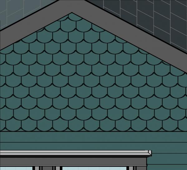

How can I get the hatch to not be upside down?

I had to add a line in the .pat file to make this a model pattern. Replace the first line with:
*Fishscale shingles,Fishscale shingle pattern-reversed for use in Revit;%TYPE=MODEL

anybody figure out how to make this pattern display right side up? it imports with the shingles upside down - thansk!

Just grab one of the vertical lines and rotate it 180 degrees.

did anyone figure out how to make this pattern not upside down? the comment about grabbing a line and rotating it 180 degress will not work unless it is a model line pattern. I also attempted change of first line of code to the text of what another suggested but it still does not register as model line in revit.

PUT IN SECOND LINE
;%TYPE=MODEL
IMPORT AS MODEL HATCH AND 12 SCALE
