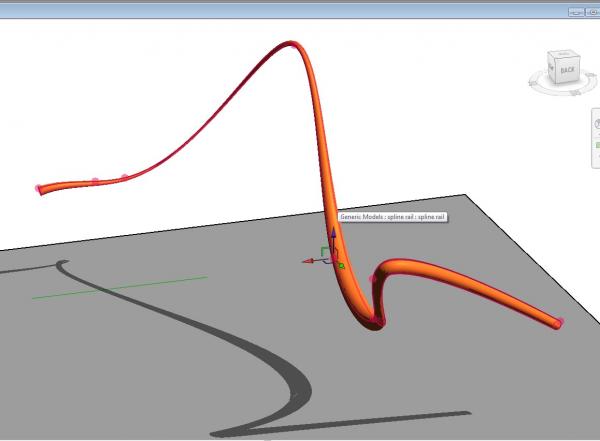

Never experienced adaptive components?!  Oh boy.
Try this out, or just inspect the family to see how it works.  This is a spline extrusion with 8 adaptive points, which means the sweep will regenerate in real time to pass through the 8 points wherever you set them.   It's quite fun to play with.  I should get back to work, honestly.
If you select the adaptive points, (you might have to tab) you get X-Y-Z grips to moved the path manually.
I've added 8 new parameters to control the diameters of the tube, and any differences in diameter between adaptive points will be smoothly transitioned.
