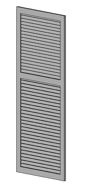

This is a complicated, parametric louvered shutter.  It may have some glitches, but please let me know so I can repair them.
There are three options for look.  The formula works such that it will see if you selected "Equal Panels" First, if not it will see if you selected "Square Panel" (top area square), and if not it will use the value for panel height entered.
The family will automatically adjust the louvers to the size of the opening.

Hi lizard,
Have been playing around with your louvre and think it has the potential to be very useful.  Do you have a simpler version without the top panel?  I was tried to modify yours....some observations/thoughts:
 - the louvres do not seem to be locked to the top or bottom rail...?
 - are the louvre ends locked to the side rails?
 - I love the fact that you have louvre quantities.  It would be great if you also had lovure spacing.  When I try to add louvres it squishes them together, similarly when you reduce they become more spaced apart.  I tried to add this parameter but the louvre slats are a group and they do not seem to be locked to any reference lines/plane....if there was a reference line/plane through the centreline of a louvre slat, you might be able to control that....?
