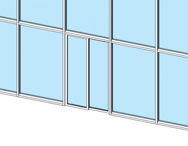

Sliding Curtain Wall Door
56955 Downloads
4 Stars from 17 Votes
Exactly what the name implies
CSI Division: 08 32 00 Sliding Glass Doors
RevitCity Division: Doors & Openings > Glass > Double
Uploaded By: origin
Uploaded On: Mon, Feb 20, 2012

cant see it in plan view
Thu, May 17, 2012 at 11:57:42 AM
hmaddahi
Joined Sun, Feb 19, 2012
there is nothing in plan view!
Sat, Aug 11, 2012 at 4:41:42 PM
neomaxmaya
Joined Sat, Aug 11, 2012
5 Stars from 2 Votes
This door is pretty cool.
but as the gang said above, we cant see it in plan view for some reason!!
maybe it has to do with some visibilty issues from the family faile! but i couldnt figure it out though since im not that experianced with families Puh
if anyone knows why please share your info.
Fri, Sep 21, 2012 at 1:59:12 PM
crwinchester
crwinchester Avatar
Joined Sat, Sep 4, 2010
3.5 Stars from 6 Votes
In the family, select the geometry and in properties panel select Visibility/Graphic Overrides and ensure the checkbox for "plan/RCP" and/or "when cut in plan/RCP when category permits" are checked. Save and reload family. Viola! Thanks for the great family!

Great stuff, automatically sizes and works in plan view with fix above!

Hi, I cannot insert into curtain wall. All my mullions and glazing is unpinned.  Am I missing something?

Hi there. After fixing the famlies visbility so it was visible in plan view., and I inserting the family into my project, the plan view and model lines where showing green. Anyone know how to fix that? Thanks
