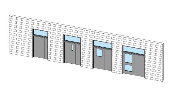

Here is a parametric door family in CMU wall with customized door schedule to match our office one.This one can show unequal leafs, different swing angles, lites, glass type on schedule; frame depth and frame setback are all parametric.1. The leaf sizes is "Type" dependant, a pair of 3'-0"/2'-0" x 7'-0", will be shown PR. 3'-0"/2'-0"x7'-0" on schedule. -if you need a pair of 3'-0"/1'-4" x 7'-0" door, you can duplicate 3'-0"/2'-0" x 7'-0", go to "Element Property" cahnge the "Width2" to 1'-4" and rename it accordingly, it will show on schedule.2. The swing angle is an "instance", you can click the door #11, go to "Element Property" change "Swing angle" to 50, it will be changed on plan.3. The lite in active panel has three configurations, and a flush one. -go to door schedule view, under "Door Type" not "(2) DOOR TYPE", for Door # 12, if you change the number to 3, then go to 3D view, you can see the lite changed.4. Type of glass is an "instance", you can un-check the box "Exterior Door" on Door Schedule, the "(5)GLASS" will be changed from SGI to SG. SGI- safety glass insulated, SG-safety glass.5. Frame depth and setback (for masonry wall) are all "Family dependant", since I think that each project should have the same setback, if you want, you can modify  it and make it a "Type" or "Instance" parameter.Then you can go to Sheet A101 to see the print format of the door schedule.
