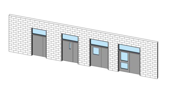

Here is a parametric door family in CMU wall with customized door schedule to match our office one.This one can show unequal leafs, different swing angles, lites, glass type on schedule; frame depth and frame setback are all parametric.1. The leaf sizes is "Type" dependant, a pair of 3'-0"/2'-0" x 7'-0", will be shown PR. 3'-0"/2'-0"x7'-0" on schedule. -if you need a pair of 3'-0"/1'-4" x 7'-0" door, you can duplicate 3'-0"/2'-0" x 7'-0", go to "Element Property" cahnge the "Width2" to 1'-4" and rename it accordingly, it will show on schedule.2. The swing angle is an "instance", you can click the door #11, go to "Element Property" change "Swing angle" to 50, it will be changed on plan.3. The lite in active panel has three configurations, and a flush one. -go to door schedule view, under "Door Type" not "(2) DOOR TYPE", for Door # 12, if you change the number to 3, then go to 3D view, you can see the lite changed.4. Type of glass is an "instance", you can un-check the box "Exterior Door" on Door Schedule, the "(5)GLASS" will be changed from SGI to SG. SGI- safety glass insulated, SG-safety glass.5. Frame depth and setback (for masonry wall) are all "Family dependant", since I think that each project should have the same setback, if you want, you can modify  it and make it a "Type" or "Instance" parameter.Then you can go to Sheet A101 to see the print format of the door schedule.

How do you get both dorrs to show as glazed door rather than one glazed and one solid.  As when you change the type under Door Type # it only changes the right door and there seems to be no way to get the left door to be glazed.

PROBLEMS:
1) Door Height cannot be changed:  Door is not anchored to floor
2) Transom Panel height cannot be changed
3) Second door panel cannot be modified.
