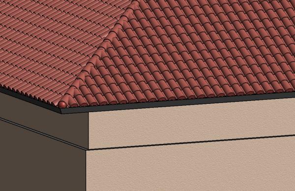

You need to download all three files. Draw a model line from bottom to top on your roof face and array it at 9" spacing. Then trim each line to correct length, and use the second file (line based) for any tiling row that needs three or more tiles. Just select the lines.
Use the third file for the spine tiles (same process just draw a line on the spine of the roof).
Use the first file for any rows that are two tiles or less in length. If it needs two, check "2nd tile". If not, leave unchecked.
Materials parametric, be warned it will make your model pretty heavy.
