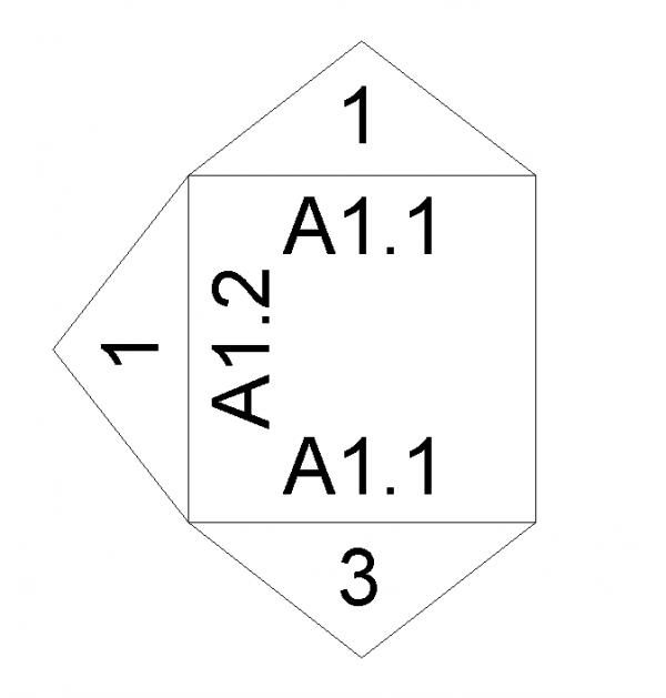

Elevation tag that can have a different page number per elevation triangle.  How to load into project:
With this elevation tag family file open and a project file open click on load into project.  Then in the project file, Manage Tab, Addtnl Settings, Elev Tags, it should be in the value drop down box - choose it. Then, duplicate a new type for this new tag.
When you do a new elevation, edit the type and in the Value box of Elevation Tag Graphics choose the little box in the upper right corner that shows up when you select this Value box. Then at the next window choose the duplicated name from the type drop down. FAV Elev Mark or the custom name you created.
