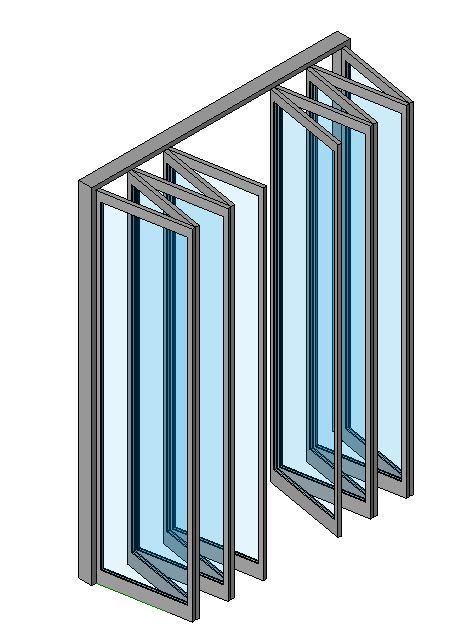

Parametric folding curtain wall doors. Based on fabioloretti's folding doors.

It works fine in 2013 as well. When you load it, look for it under the "Curtain Panels" Section of the project browser. I created a new curtain wall type with no horizontal grid pattern and a vertical grid pattern fixed distance of the entire opening. I Then spacified the "cutain wall folding walls" panel as my cutain panel and created the wall in the project. Not sure if this is the best way but it sure worked nice.

Solution: Go to Edit type. There is option for left panel and right panel

Amazing family, great job AndyHarle. Works excellently in 2016. Although...
One issue I am having is setting panel number to anything greater than 5. When you make it 6+ (I need 7), the family appropriately shrinks the panel width, but DOES NOT increase the number from 5. Looking in the family, allowance has only been made for 5. I am no expert in delving into others parametrics, anyone got any advise how to modify?

@AAHAS
You can not create more than 5 Panels with this family. The panel "creation" ist not fully parametric.

Thanks! This door worked great! I was able to have 3 panels on the right and 4 on the left.  If you want to show the doors closed, just change the open angle (under dimensions) to 0.
