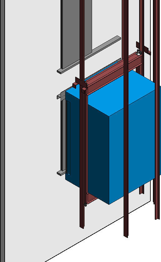

Passenger 2000 to 4000 and Service 4000 to 5000 elevators all in one family. This is a parametric elevator that can have up to 10 stops. There are many paramaters that you can control like amount of stops, distance between stops, frame size, etc.

If you hit the spacebar before you place the elevator in a wall, it will mirror it so the door opens on the other side. And you can change the number of stops in the properties bar, under Construction. It is named, "Elevator Number of Stops"

To reduce the number of stops select the elevator and then look at the property menu. Under "Construction" you will see "_Elevator Number of Stops." Change this value to a number between 2 and 10. Also make sure your distances are set correctly under this same section. Generally they should match your ceiling height.

If you get a message saying its not cutting anything it means you neeed to attach it to a wall

I really appreciate the kind words...If you want to know the truth I have not been on this site in a very long time...I was actually surprised this was still on the site and even more surprised to see the amount of downloads...I did this family back in 2008 back when no manufacturer had a parametric elevator...I reloaded the family and unforturnately I did not make it to have a R or L opening...Just the different sizes...I have not used this elevator since manufacturers provide their own BIM products now...I will say that I think this elevator is more graphically pleasing than the manufacturers...
