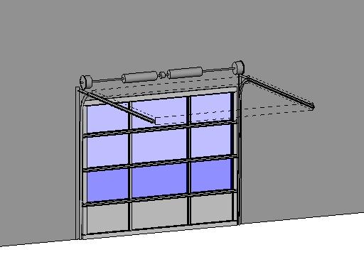

Clopay Commercial Sectional Overhead Garage Door - Model 902
Complete parametric Clopay model 902 door with adjustable size and track options accurately representing the true consumed space of the physical door in both open and closed positions, allowing for plan details and interference checking to precise dimensional requirements. Model 902 - 2-1/8" thick sectional overhead aluminum full-view garage door. For more information, specifications, CAD files, and additional Revit family downloads please visit www.clopaydoor.com.

Why is the track visible in plan?

I would like to have the track not visible in plan view.  is there a way to turn this off?  Also,  I am wondering if there is a way to make the door show up, in elevation, no matter the wall thickness?  Please let me know soon. Thanks

Just edit the family, click on the track, and edit the visibility settings. Just unclick "Plan/RCP", load into project, and you are good to go.

A bit of a newbie in Revit, How do you adjust the height and length? Everything seems to be locked.

If you dont want to see the track in the plan you need to adjust the view range to below the track.
