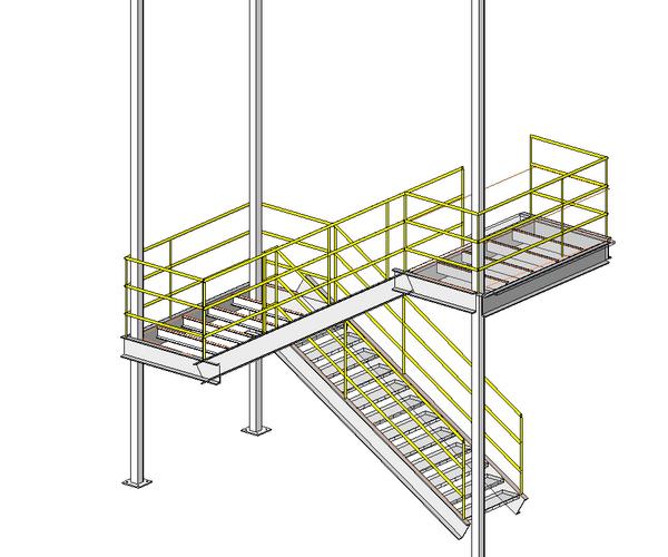

These Stairs could Ruin your day.  Thats a warning.  They are an attempt to fill a gap in the stair department.  Industrial steel stairs are a basterd to build.
This is in a RVT file which you will most likely have to group then copy and paste.  Check the elevations on this drawing as you will need to have the proper levels in the new drawing ready for a cut and paste.
The railing is the best and most accurate part.  Landings will have to be redone as well as many cuts on the stringers.
If they really truly suck, I'll delete them off the site.
Good luck, hope this helped.

 I had a similar task when designing an internal stair for a competition were we were looking for an industrial look staircase. I am not sure as to how you constructed the stairs but if you use the stair tool to build your stairs you can then load a profile of a c section and use that as a stringer in the stair element properties.
 This way you will get a fluid c section stringer.
 Hope this helps

But you get no parameters that way and it is evil to work with.

You can always copy the railing and paste it at the stringer level and change the profile of the railing to what ever steel member you want for the stringer.

Thanks for this. A great combination of elements to make more custom stairs.
Needs a bit of cleaning up and the stair run could have a channel profile stringers. But otherwise thanks for doing the labour

Havent opened it yet but can you do a steel connection on those stringer joints?
