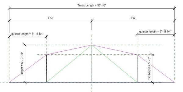

So im not sure if anyone will find this usefull but it took me a while to figure out so i figured i would share it. It is a truss that has a top cord split into 4 segements. It is setup that the 4 segments will always be the same length, which is calculated by the truss length and radius that you input. Im not sure how useful it will be to everyone but it could be a good reference if someone is trying to do something similar.
