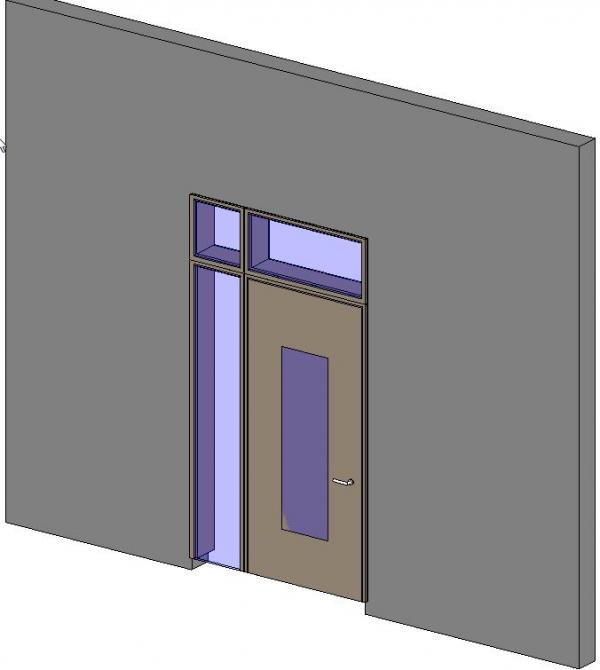

Full Parametric! You can choose between wood or glass paneel and everything is flexible!

The properties are in german, making is very hard to use the parametric functions as you have no idea what you are editting!

Türblatt_Voll = door leaf complete
Glasausschnitt = a glass in the door leaf --> no check in Türblatt_Voll
Seitenteil = side plate
Oberlicht = Overhead light
Höhe Oberlicht = high from the Overhead light
Breite = width from the door withou the side plate
Breite Seitenteil = width from the side plate
Höhe = High from the door without Overhead light
I hope i can help you!
